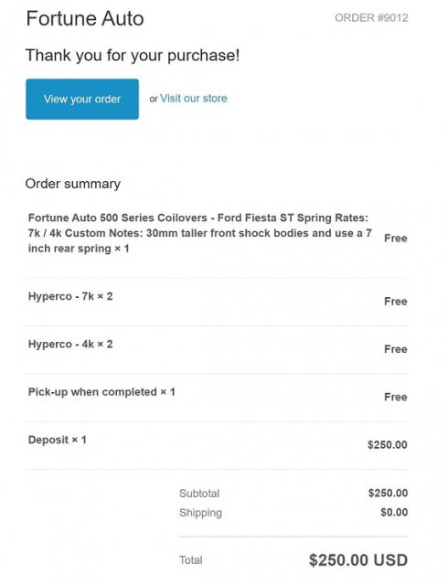

Well, took the plunge. Spoke to Devin. He said their "off the shelf" coilovers are 1" lower than factory ride height at their highest setting.
They are able to build the coilovers to maintain factory ride height and still have the adjustability to drop 2" from stock height. I was actually VERY surprised there is no extra cost involved to keep stock ride height. I went with the Hypercoil springs, 7KG front spring rate and 4.2KG spring rate in the rear.
Lead time is 4-5 weeks. I can't wait!

My order has now been confirmed. =D
Just put a deposit down. I will complete the purchase when I pick them up in person and inspect them.
