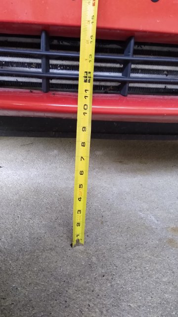

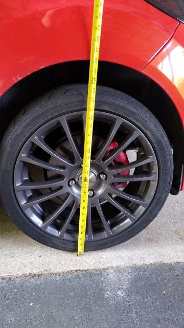

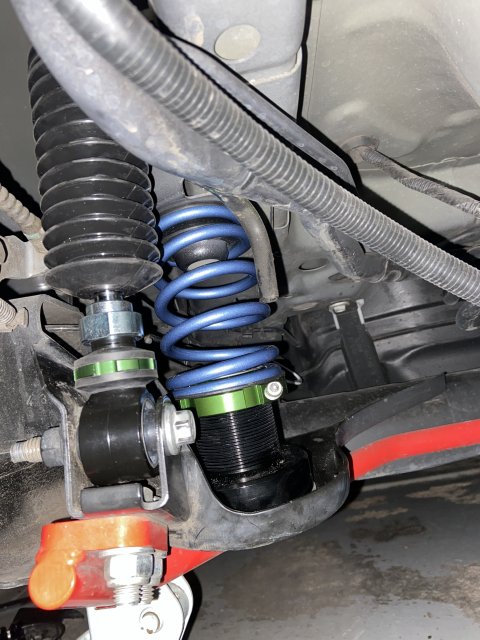

For you M-Sport fan
Highest adjustment. I might be able to go 1/4" higher in the rear. I've driven approximately 80 miles with no issues other than slight loss of traction on the front... 😆
Sway bar angle is terrible and barely clears the control arms but would be correctable with adjustable end links.
Ride quality at 12 clicks on front and back which is halfway between soft/hard is very acceptable. No huge potholes around here but some big bumps and they have handled it just fine.
I imagine they could produce rear spring perches to match the front ride height.
Sorry if my measurements aren't perfect but should give you a good idea.
215/40 Dunlop direzza zIIs.

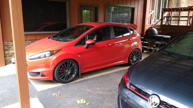

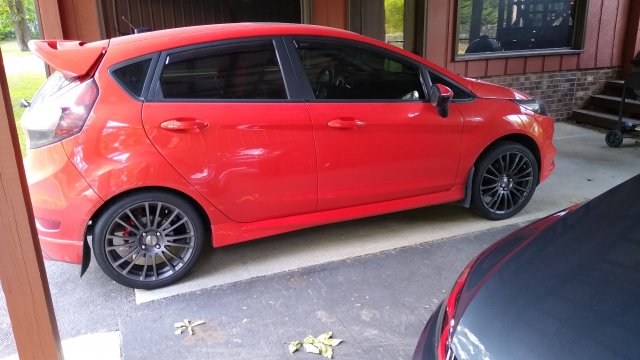

Lowered everything today. I think I'm approx 1/4" lower than stock right now.
I lowered the front 2 1/2" and the rear 1 1/4".
Not much more lowering room on these coilovers. I can go about 1/2" more in the front and only 1/4" in the rear. I'm perfectly fine with that though as I don't want much lower from stock anyway.

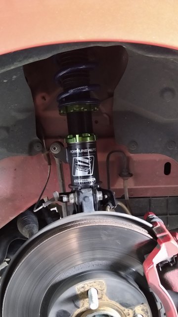

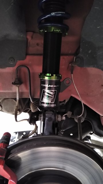

I’m installing a set of 500’s and a little confused on how the spring perch sits. The sticker says above the spring but the instructions show below. It looks like it’s meant to install below, but the stickers says a above. Does anyone know how the spring perch should be installed? Right now I have it belo the spring.
haste
1,222
1,267
Eastern
#49
I would install it above. It is flattest surface and stays that way at all times. Installing it below will most definitely damage the perch. My buddy with ST coilovers, has destroyed his perches because his installer put them on the bottom.
