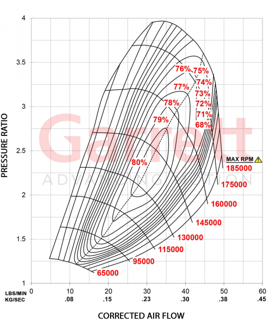

Why you tell about 30+ psi for g25 turbo? The compressor map of this turbo tells that the efficient area of this turbo is around 25 psi.

Stellios, there is a disappointing amount of hard data compiled on these setups. I tried looking online at anyone that ran the t25 .49 vs the vband .72 . There wasn't anything in any forums with numbers. I saw some guys spit balling hypothesis on a Miata forum, but most threads died last year with no numbers. I also haven't seen anything on our cars that have back to back comparisons on cams. Unfortunately our engines get unreliable in the 400whp and there hasn't been any shops really throwing down, or sharing data. I do recommend following Dizzy once he gets his new block built with Mountune V2 cams. https://www.fiestastforum.com/threads/engine-build-v1-0.28912/page-3
With all that being said, s280 can make the power you want on ethanol blend, and the g25 can also make it, although it is going to be lazier and hit full boost around 400-500 rpm after (estimated) with small turbine housing compared to s280's 3500ish full spool. The .72 is most likely going to be around 4400, but might be able to make the power you seek on just premium 93 due to less drive(back) pressure and higher VE. I'd really like to see someone do a pump gas max effort car, but its a lot of money and not much incentive(return on investment) to explore things. I'm grateful for any shops or individuals that care to share their results.
My ideal setup I'd love to see someone do would be a sleeved darton block, some i-beam con rods, dual valve spring, custom high lift camshafts with upgraded HPFP lobes, custom pistons with lower CR around 9.0 to 1. Tubular manifold with a back to back dyno session with different turbine housings. A guy can dream i guess? My buddies shop has been building Can-AM x3's and we've been exploring the limits of the engine and making bespoke parts. Side by side owners seem to have much more discretional income though. I hate to sound old, but Fiesta's are just so good around 300whp that their isn't much of a market to reinvent the wheel.
*edit* i attached compressor map incase people wanted to reference it without having to google it.
