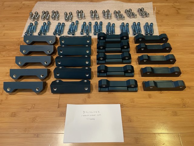

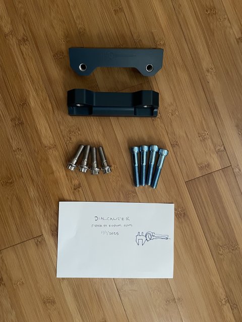

Awesome partial update! The machine shop delivered a little early, so I have the brackets in hand! I’m going to start working on packing them up to ship this weekend and will hopefully get most of them out this coming week, along with finishing the instructions!
Stay tuned!
