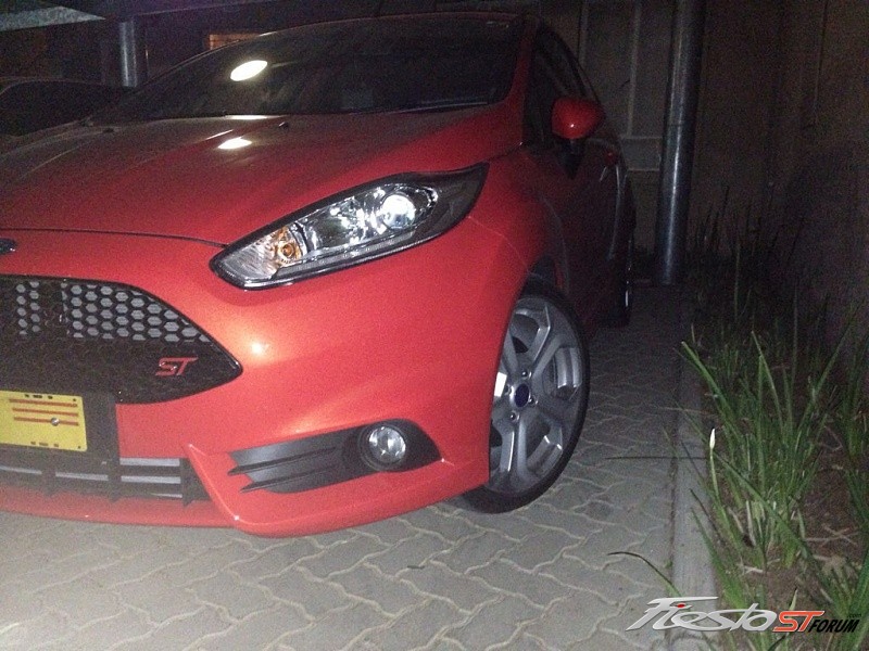

Just thought I'd share these photos of my car after the successful install, after getting a Micro Add-a-circut and putting it in Fuse 23
With headlights on, with low output on the LED
With high output, no headlights. as if DRL
With low output, for parking lights?
Thanks again for the kit!

Glad you're enjoying it! Thanks for sharing the pics [emoji1303]
