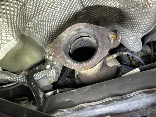

Tried to install catback, down pipe bolts had rust welded themselves, cut off bolt, removed pipes and now am stuck with broke and cut studs in my flimsy down pipe where do I go from here, I absolutely suck at drilling out bolts btw
What attachment did you use on the air hammer? Should be a pointed punch. Also cut studs as flush to the flange as possible. It will absolutely work done properly.
