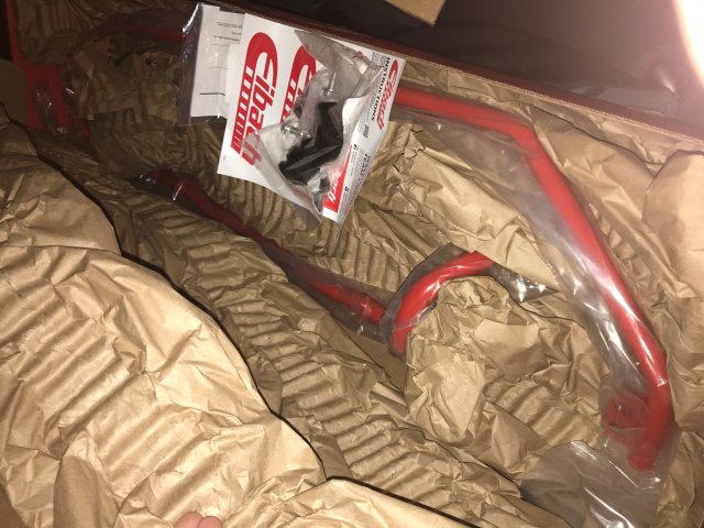

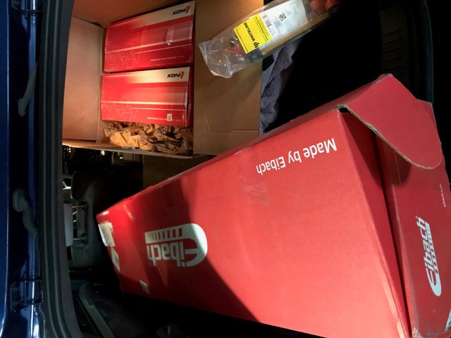

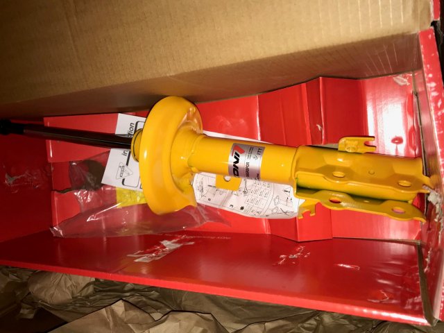

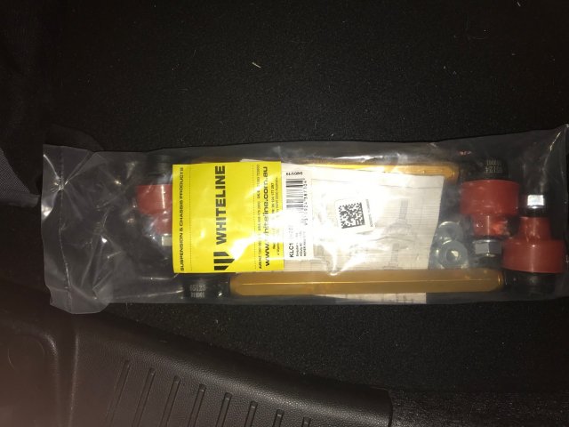

Ok, So…Lots of talking on my part, finally some action. This showed up last night:
Pretty much the standard formula for HS class.
Koni yellows (front), Corksport (Rears)
Eibach Sway bar (Front initially) to test early in the season.
I may try out the rear bar later…depends on the front results.
Whilteline adjustable end links

Whats the reason for going Corksport on the rears? Also have you run events on the stock FSB? I am very interested to get opinions on this change. A setup guy was waxing about how the common logic on the FWD cars is to do the rear bar, but with the traction loss coming out of corners on the FiST a front bar could keep the inside tire down letting you get out of the hole better...
Two reasons, really:
1) I had them already – swapped from my mazda2
2) Dampening is adjustable on the car, just reach in the wheel well over the tire. Adjuster is at the top of the strut.
I have not run any events with anything but stock bars at both ends for the last 1.5 seasons (So 20+ events).
As far as impressions, I always felt the car was very tail happy, especially in quick transitions situations (Like slaloms) this could be tuned somewhat with tire pressures but I am wanting to see if the reduction in Camber gain theory holds up for the FiST.
Keep in mind I am only a regionally competitive driver so anything I say is questionable! ;)
We are still several weeks out from our first events so we will have to wait and see.
