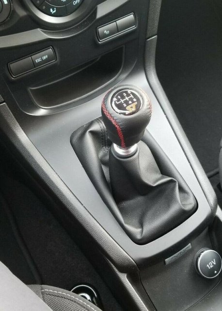

Hello everyone,
I created an account just to ask this. Is the shift boot plate trim suppose to be flushed with the sync logo. My plate is loose now and I can fit my fingers underneath it.
I pulled this image online. I am talking about the plate that holds the shifter and the console together. Are you supposed to be able to easily pull it up or did I ruin my car already.

There shouldn't be a gap or anything but it does overlap a bit and you can pull the plastic up if you try. It's pretty flimsy.

Pull it off and when you install it make sure you press down first, then slide forward toward the dash.

sadly that didnt work. do you have any other suggestions?

make sure all the tabs are going in too or that part is going to be hard to get flush. or that they arent broken.
I would start from the top and use one hand to clip in around the AC controls while using the other hand to hold and slightly pull the other end as you work your way down.
Then as @bflan2001 said, pull out - press down - push in

i figured it out haha, turns out one of my pins were broken. I got in completely in there now, although my right side clip is loser just because its cracked. All good tho. I appreciate it guys
