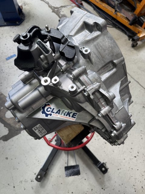

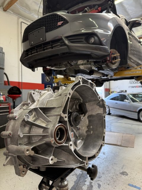

Hi getting this trans built after lost my reverse gear few months ago. Decided to get a Colby trans build with WPC treatment and Wavetrac lsd. Got a new oem trans to start with. Took a few months but hopefully trans is shipping out this Monday. Was recommended by Colby to go with DCT fluid and going with Amsoil DTC. Hope it'll work good in high temp track days in CA around 90f

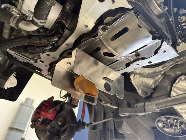

-Pro Alloy oil pan baffle

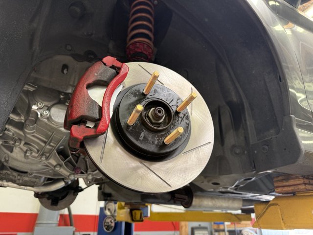

-Extended ARP 3.25" brake studs, Stoptech slotted rotors, G-Loc R8 pads (replacing Hawk DTC-30s all around), Endless rf650 fluid.

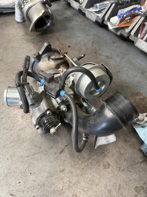

I do have an S280 turbo, but not really sure it's a good idea to throw it on right now, before seeing how the transmission operates.

are there additional parts to address reliability of the s280? I hope it doesnt create needless added heat that might melt the wiring.
was interested in the whoosh cermanic coated exhaust manifold but its out of stock with an Aug eta
Shouldn’t be a problem, you can retain the stock heat shield with it unless you do a tubular manifold which I would advise against unless you’re having a custom heat shield made. My tubular manifold melted the wire loom. I was lucky to catch it before any actual wires were damaged.

I wonder if it is because of the WPC treatment on the gears that they suggest (or require for any warranty??) the DCT fluid, even in open track use?
Did they give any rationale for that at all?

Are you still on factory front brake calipers, or an aftermarket BBK?

I definitely informed Colby that I do intend the trans for track use in 20-30 min hpde around 90ish f temps. No real rationale interestingly and I think it may be for the WPC would be my suspicion as well. Even sent a link for the Amsoil DTCF that I was going to get and he confirmed.
He did not recommend the motul gear 300 that I usually use.
No BBK. Just factory front although w/ diff pads, rotors and endless fluid. I like enkei rpf1s but where they fall short is poor caliper clearance.
