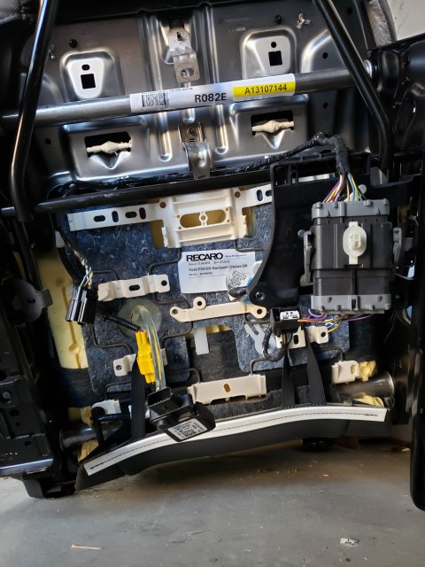

So I tried to do some more swapping around of upholdstry and seat backs for a different look to better match my 2017 interior. Come to find out that even using the Fiesta recaro base, my Focus Recaros are a different back with different, wider attachment points. Im going to try and spend some time tracking down why this is, maybe I got ST1 Focus Recaros? Only thing I can think of when it comes to this. While some Focus Recaros do work for this swap, I can confirm 100% that NOT ALL FOCUS ST RECAROS WILL WORK IN THIS SWAP! Ive seen people claiming in this thread that they are the same. Be advised that some might be, but not all are.
What I can tell you about my Focus Recaros is that the airbag was not in a nice square plastic box like the Fiesta or the Ford Racing Recaros swapped by Zero. It was basically just wrapped up around itslef with the firing charge. I dont know if that means it is an early model ST1 Recaro or what, but its the one of the differences I found between my working Fiesta Recaros, the Ford Racing Recaros Zero got and the Focus Recaros that I bought. The other difference is of course that the seat back of the Focus Recaro is different, the attachment points coming off the seat back are wider than those on my non recaro Fiesta base and also the recaro Fiesta base.
Best I got right now guys, hope this keeps someone else from jumping in headstrong like I did or at least is aware of what you are getting into when you pull the trigger.

I can matter of factly tell you that 15+ seats will not work. The rear seat frame design changed in 2015 and it does not bolt up to the fiesta seat base. The only way to use them is to drill out the focus mounting points and weld the fiesta ones on.

The rails and frames changed in 2015. I didn't find that out until I actually re-built a set for some friends who had FoSTs and wanted to trade seats. Its crazy that they made like two little changes but it just screws everything up. You could "make" it work but you'd have to drill out the bolt threads on the seat back sides and then put a sleeve, bolt, and nut on. It would work but I dont know how they'd hold up in a wreck.

I would do like Nick did and modify the mounting points well before I modified the actual seat itself. You can bolt everything together like he did, then weld everything in place and it will be just as good and safe as the factory stuff. But modifying the seats themselves, specifically the mourning points? I wouldnt do that.

Yup. Aside what I said a couple of posts up (what Nick did) and doing this, there wouldn't be another way. However the airbags bolt up the same way, so you could drill off the brackets, weld on the fiesta ones, and still be able to make it work. FWIW the 2015 FoST seats are really nice and I prefer them to the FiST and 2013-14 FoST seats.
