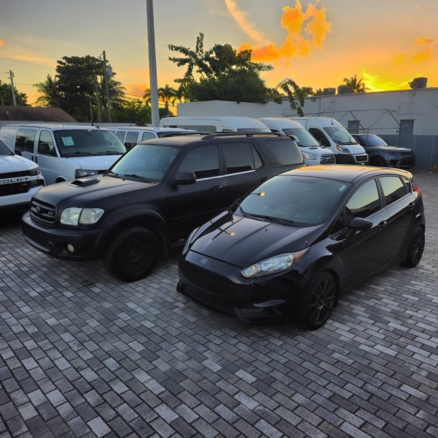

Hello Everyone! This is my first time ever in a community Forums and it's such an honor to be here!
I just purchased a 2019 Fiesta ST (Mk 7.5) here in the US with 73k miles on it and I am so excited to begin this journey with it.
