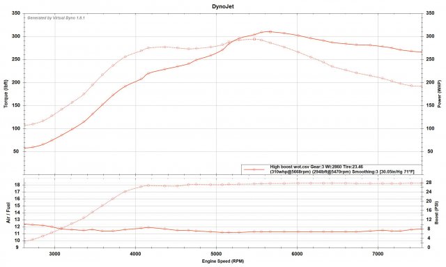

Alright guys, so I've realized I had some inconsistencies with boost prefer relative to what pumaspeed says I should be making and when the car is actually making it. I posted on a facebook group and mitch told me to check my actuator. This was one of the things I had that guy rob at the beginning of my build install and well.... he installed yet another thing incorrectly. There was no preload on the actuator. I was making 14.5 psi of boost at 3750 rpm when I should have been making that at 2750. Car pulls really hard and when it stops raining I'll try to get a vdyno for you guys. I think this is the last thing rob touched that I haven't looked over so I shouldn't be having any issues after.

I have 2 catch cans and have checked them and regularly check them. I have no boost leak. Tightening the actuator the the correct preload fixed the issue and I'm getting it to spool to 1 atmosphere far sooner. A lot of people told me my engine mods are gonna push the spool farther to the right of the power band.

I'm wondering why as the rpms go higher and go over 5500 I'm tanking in hp. I did do part of this run on an incline. Could that be the issue?
#3304
11,899
8,339
Needs to be a flat road....bump free or that cab skew the datalog.

Thread Starter #429
Ok. I'm gonna need to find a flatter road.
Probably spinning tires a bit or hit a bump. You have GTX spool, usually on catch cans that go to the manifold you should have a check valve or it can leak boost from there. I've had the issue along with some friends as well.

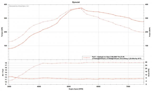

Alright guys, another dyno reading. Actuator had no preload on it so I'm basically starting the tune over ugh. But I opted to not do a normal fueling tune so it will save more time. decent.jpg
