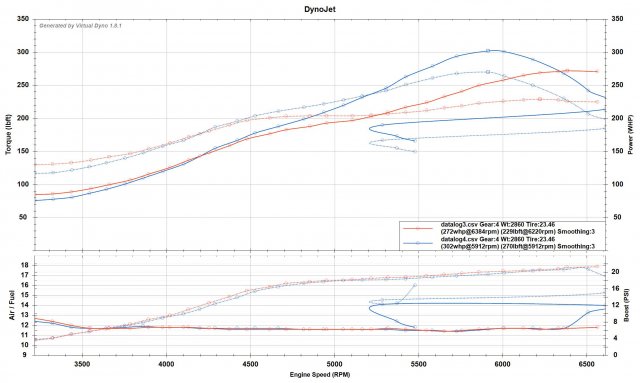

It really doesn't translate well on paper how this graph feels though. Its like, as soon as 4500 rpm rolls around the car just spikes its air mixture and is a rocket. I can barely shift fast enough sometimes because of how quickly it starts revving after 4500. I'm not slipping at all in this graph. I tried doing 3rd gear pulls but I just make too much power and my gear ratio is too quick to do pulls in that gear. I feel like by the end of this I'm gonna need to start doing fifth gear pulls. Also, car gets up to 140 really quick haha. Mind you, this is all at spring pressure. It's got a 19 psi spring in it. We aren't even at normal boost yet. I assume Adam will crank it up after this.

I think its the whole entire Peron Garrett setup Vs the Pumaspeed that you had been running* Ill put money on it I will say the same thing when i install my DHM kit soon. All things new create a feeling of exhilaration that gets old with time as we get used to it and it loses its luster but still is enjoyable...Just not like it was the first time.
