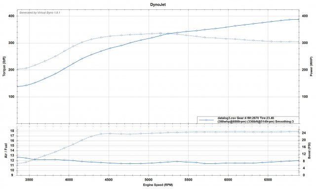

So I think this is just about as best as can be done on pump gas. I think my next vdyno post will be e85. Looks like the max I can push is 26 lbs. Adam says anymore than that and I'm gonna be past the knock threshold on 93.
That is wild for 93. Looks awesome man. Glad things are finally coming together for you.
