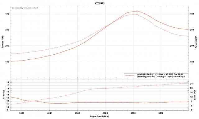

Some progress. Torque is going up. Boost is kicking in sooner. Slight power bump. Still crazy to think, I make the same power as the stock car does at full tilt... at 4400 rpm and at only 16 psi of boost. Boost comes in at 1 atmosphere at 4100 now. It was 5k. 3rd revision.jpg

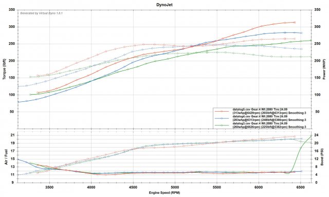

Thread Starter #511
For anyone curious this has been the progression since starting on the base tune. Looks like I'm gaining 20-30HP per rev at the cost of 2psi extra of boost. So, without thinking of diminishing returns here. I predict at 36 PSI I should be making 673? No that can't be right.... I guess we will see.

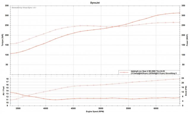

Revision 5, Hit a rock in the road mid pull and it kind of messed up the log. Smoothed it out to 6 and cleaned up the log and reposted on vdyno. pull 5.jpg
Se7eN
#2001
904
786
I'm assuming the logs in 4th are due to cold weather and no grip, looks good
R
Rocketst
#9630
1,272
847
Thread Starter #514
Yeah, I think that's why I was having trouble with 3rd. I have made a habit before I make a log now of warming up the tires a little bit cuz it helps a ton in addition to doing the logs in 4th. Adams been tuning this thing great. I'm very pleased.

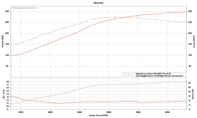

Thread Starter #518
Still trying to get the boost to kick in sooner. 14.2 PSI by 4163 rpm vdyno.jpg
