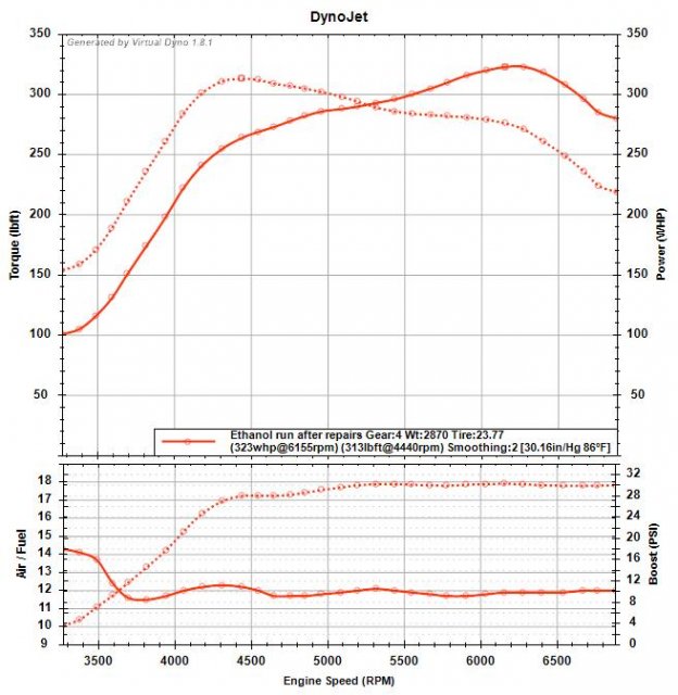

So here's where I'm at with the tune. Second revision e50. Y'all will notice this is considerably lower than my other posts. Silly me forgot to change the final gear ratio because I'm not using 3.82 anymore... I also needed to make some repairs as you can see by the title of the log haha. I've managed to damage my wheel bearing and have lost vss for about 15 mins during the first part of driving when I first start it. This is a minor annoyance. I just ordered brand new knuckles, bearings, abs rings, and retaining rings to fix this as well as ordered brand new axles (don't ask) and rons big brake kit. I'll have pictures as soon as the axles get in as I'm waiting on them to ship. They were special order. Notice that wonky fuel trim throughout the run? Not sure whats going on there.
