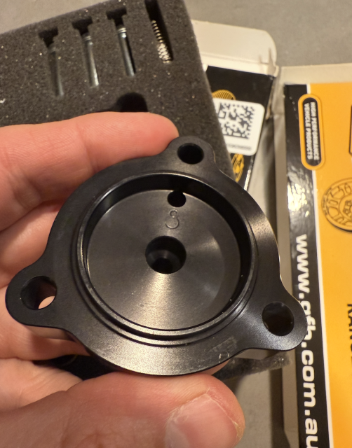

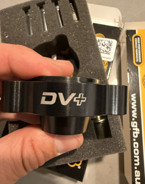

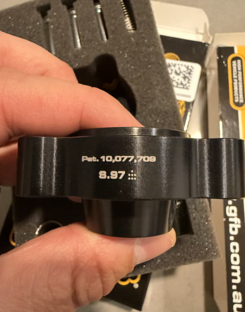

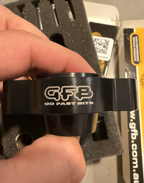

Can you post a pic of the logo and patent number on the valve? The font/size can point to counterfeit. Also the foam seems off. It’s usually more dense looking.
Other odd item as you mentioned is the blue o-ring. Even the counterfeits have the red rubber seal. Strange.
Yup - see below.

Some more odd things I notice:
1. On the patent print side, it should have the model number “T9358” on it.
2. On the under side, where that engraved “S” is, it should actually be an “8”.

Heard back from GFB. Sounds like this is normal.
Thanks for reaching out
The design of the piston seal has changed about a year ago. We went from an orange silicone seal to a blue viton seal. This has just allowed us to keep the process in house while using viton which is a particularly tough material.
In regards to the fingerprint. Are you able to send us a photo? Brass is quite reactive to oils on skin and these pistons do get handled quite a lot due to them being measured and sized to suit each individual body. It’s pretty common for brass to superficially change colour slightly where it’s been touched. They definitely don’t get heated though.
With the plunger, I can definitely understand the machining marks on there don’t look the best. The material used for the plungers is specified for it’s particularly strong magnetic properties. It’s a material that unfortunately doesn’t machine very well and produces a variable surface finish.
They used to have a black coating on them which hid the machining marks well. This coating worked decently but it was susceptible to corrosion when the parts were in storage (before going on the car where they get covered in a light oil film). The gold zinc plating tends to protect them better but unfortunately doesn’t look quite as good.
This part is not critical in dimension or surface finish so it has absolutely no effect on performance.
