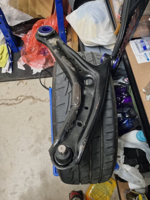

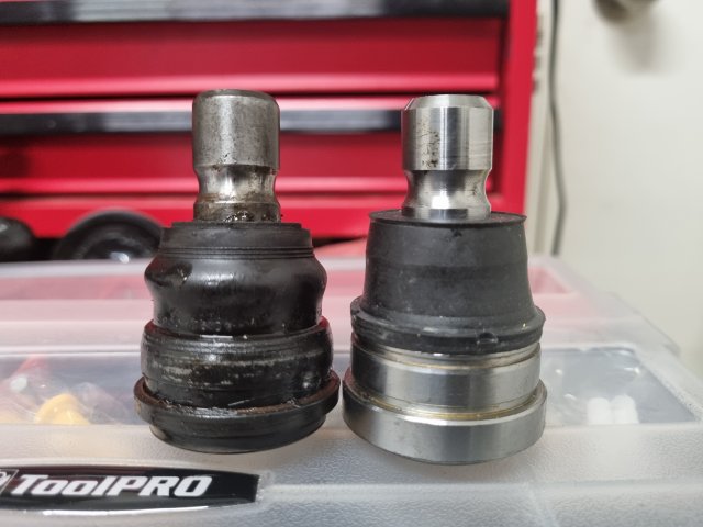

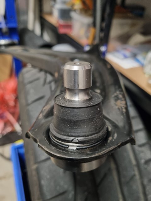

I just put in Hardrace extended ball joints and Superpro bushings.
