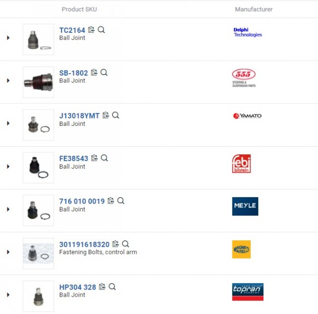

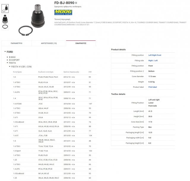

Since a have a small access to parts and parts b2b's I searched and a lot of companies actually sell just the ball joints for the lcas.
Strange detail no1: Tecdoc says the ball joint is the same to fit 1.4tdci, 1.6 zetec, 1.6 st and st200 lca (!)
Strange detail no2: The Moog ball joint part number is completely different to what some members here bought and installed
maybe a US/ EU fiesta difference? :rolleyes:
I tried twice to install ball joints but they fell apart (experienced knocking and the garage told me I should replace the whole arm). What is the correct procedure?
edit: added the cross references that seem to also fit
