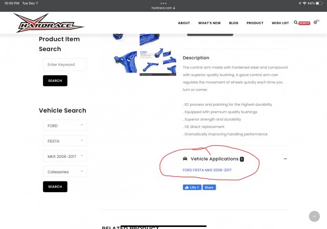

Only issue I can see with those Hardrace is they do not specify ST. The non ST control arms have different geometry while they may work they might not be correct . I would tread cautiously and talk to them first before making the purchase. I just looked up stock control arms for our cars new and they have shot up in price. They used to be pretty cheap. They are now more than double at $153 per side through Tasca.

Did you even look at the website link for the Hardrace control arms? clearly says ST

Yes I went to the website there was nothing popping up on my link that listed ST so forgive me your derision .
But Adam says they’re not ST
completely uncalled for BS and trolling on your part . I expected better from you Typhoon well he is expected to act the way he does.
P.S. look carefully it says Mk6 not MK7 and ya they made a ST MK6 in Europe and other countries . F7F9CC7B-D954-40F4-96E6-B2B3525507C6.jpeg F7F9CC7B-D954-40F4-96E6-B2B3525507C6.jpeg

Well I did something called research over on the Uk ford website and this control arm can be used in the ST models even here in America. Imagine that... there are two types of control arms fitted in the mk6 and this happens to be one of them according to the bloaks* across the pond that will also Fit the ST's* If you look these have the same style lower control arm and pinch style bolt style ball joints. If you're that worked up about it send an email to Hardrace*

Well I did something called research over on the Uk ford website and this control arm can be used in the ST models even here in America. Imagine that... there are two types of control arms fitted in the mk6 and this happens to be one of them according to the blocks across the pond that will also Fit the ST's* If you look these have the same style lower control arm and pinch style bolt style ball joints. If you're that worked up about it send an email to Hardrace*
