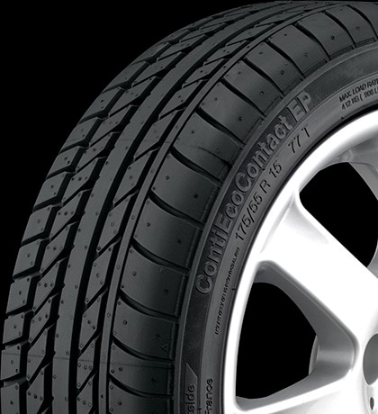

EDITED! wrong specs where I first found the tire, it is 22.4" in diameter, have to do this all over again and looking more into 16's to help make sure to clear the BBK's. (I run 15x9 over them now but a very close fit)
I found a great substitute for a light weight spare tire, a REAL tire at 12lb....and 23" diameter just like my summer tires, race tires(not that it matters since I have 6 race wheels and tires and will be close to the 16" I get for when I drop down from 17 to 16" for all seasons.
STOCK PICTURE: Actual size in the link is 145/65/15
I know it is far from a performance tire but I do not need it for that, just to get someplace to get a flat fixed or order in a replacement, etc...whatever, running none standard stuff means more things to consider and I like to be prepared.
http://https://www.tirerack.com/tires/tires.jsp?AFFCODE=AD5&tireMake=Continental&tireModel=ContiEcoContact+EP&partnum=465TR5EC&i1_Qty=4&i1_Qty=4
Now to find an aluminum 15x4-5" rim in 4x100 first to make sure it fits my BBK but I can use a pretty thick spacer if needed as have long race studs installed.
Though I am all about saving weight, as likely noted 100+times on the forum, I am also inclined to carry a spare I could actually drive on a bit further and faster than the normal compact spare.

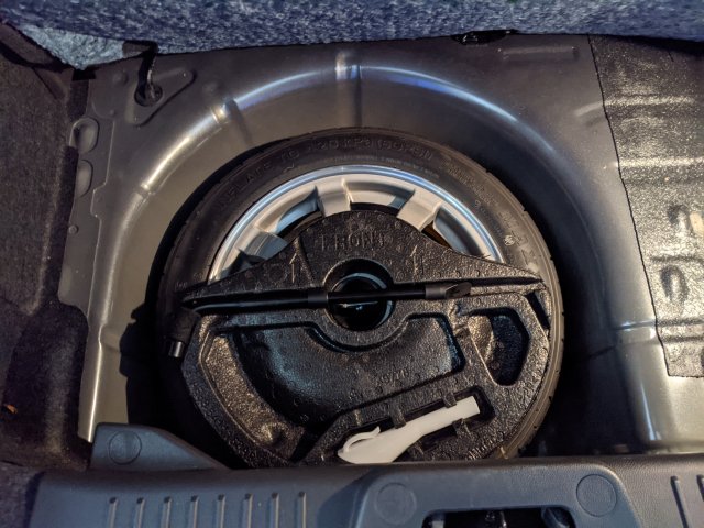

OEM Alloy Wheel tool kit has a different Jack with lug wrench sitting on top foam piece. The Jack mounts with the spares retaining pin unlike the ST where each have separate retraining pins. Might save some weight on the flimsier jack especially if you could find a light weight lug wrench to replace the steel one. Wouldn't have bothered, but I could get the spare to clear the factory jack.
Shorter retaining nut is helpful. The white one is for the alloy spare the longer black on is from the ST.
120
37
Columbus, Ohio
#52
Fiesta jack position with the washer on jack lined up with the top hole of the mount which is different from the way the ST is mounted.
You can ditch the heavy tire iron of the Fiesta and use the one that came with the ST as it is much lighter. The foam just needs to be trimmed for it to fit. The foam insert is held down around the tire iron with a thick rubber band that attaches to the hook of spare tire retainer. Somehow the puppy got it and it either ate or hide it, so it is not in the picture.

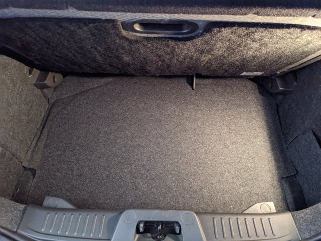

Thanks for this info! I went with the Fiesta SE standard floor (D2BZ-5813046-AD) to finish it off. Nice and sturdy, but light!
At $70 new, it was cheaper than any of the rubber mats. I just wanted the full storage area, so I don't need the protection of the plastic anyways.
