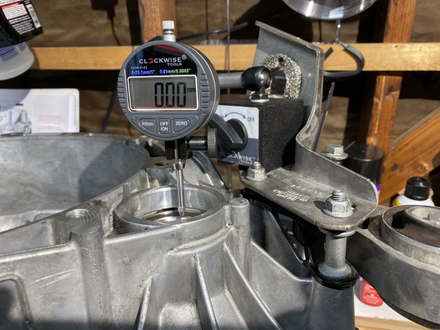

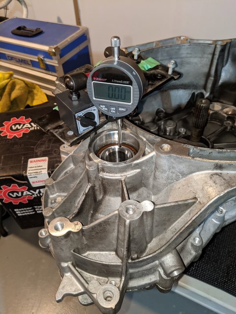

I ended up needing a .30 shim to replace the stock .50
Odd theres so much variance. I saw a post somewhere on here where someone needed a total of like 1.3mm shims or something. He also shimmed both sides for whatever reason
I rebuild industrial gearboxes, you have to find total endplay , shim one side for proper gear engagement and subtract the difference to add proper shim stack for the other side.

How come most FiSTs are just shimming one side?

No, I purchased shims after getting my measurement. So i just took the measurement after removing the stock shim.
Gotcha. Measured mine last night with a 0.1m shim. Average float ended up being 0.34mm+0.1mm for the measuring shim+ the 0.14mm Ford tells you to add, ended up needing a 0.6mm. Hopefully that helps my case
Same average float I had. Ended up being .58
.58 doesn’t exist. Rounded up to .6

I’m undergoing this process right now and it’s been quite the adventure. I just measured end float the other day and came up with 0.1 mm, pretty consistently, bringing the shim thickness to 0.24 mm. The closest shim size is 0.2 mm so that’s what I’ll be using.

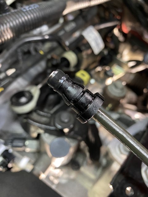

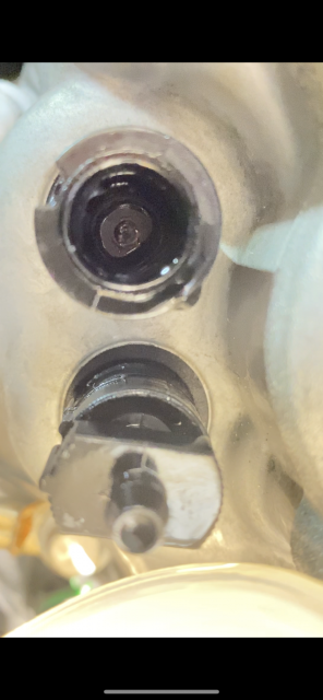

Has anyone had issues with the clutch line leaking at the slave cylinder/clutch line fitting after reassembly? I’m using a new slave cylinder and I’ve transferred over the rubber nipple from the old one and it seems to fit perfectly (photo of the nipple and fitting is attached). It’s not dripping but it is seeping fluid from where the little retainer clip slides into the slave side of the fitting. I also verified that the thick gasket is in place in the very back of the slave cylinder fitting. Thoughts?

Mine leaked after reassembly and I was so annoyed but then later found out the black grommet thats on the end of the hardline that you see in your picture, that goes into the slave and mine somehow popped off the line while it was out of the slave and was missing. I ended up just buying a new hardline from Ford for like $11. I can get the part number if you'd like. As far as I know thats what seals the connection there

Is this the grommet that you’re talking about? This is out of the old slave cylinder fitting, but I didn’t move it to the new one because it seemed like the new one already had its own. I had to really pick and pry at the back of the old slave connector to get this out.

Mine was the one thats attached to the clutch line itself, it wasn't in the slave

Ok well I’ve got that one in at least. I’m really out of ideas so I’m just going to roll with it as is and monitor the situation closely. Maybe it’ll seat better with time/heat...
