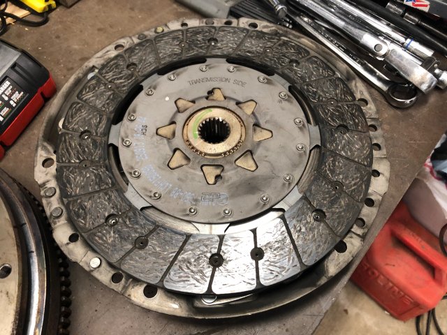

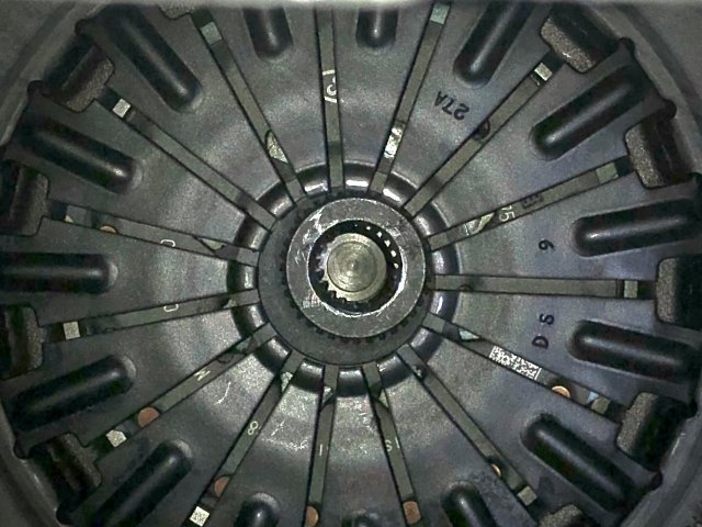

So I removed the tranny, installed the LSD, and when I go to install, wrestling with it for a while and then I back off... this is what I see... WTF... spline is ligned up with the crank but what’s up with the flywheel and the pressure plate, clutch center? What’s going on here? This is a direct head on shot aligned with the splines so everything should line up, shadows from the work light can be deceiving.

It’s always something, what’s up with the clutch? I wonder if I screwed something up removing the trans but the center was aligned with the crank.

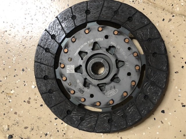

Somehow, during removal, you moved the center plate in the clutch out of alignment. Here is a pic of mine when I removed it from my car. You can see the small triangles all line up with the slots:
I'm not sure how to remedy your issue. Are you able to move it by hand? Perhaps if you gently pry it into place. I'm really not sure. Anyone else have this issue?
View attachment 31320 View attachment 31322
No, this isn't from you removing the trans, this is torque stress on the clutch disk. Good thing you caught it now before it failed entirely, also this potentially would have eventually stressed your input shaft to the point of breaking. Not the first time I've seen this.
Definitely replace it.

Thanks, ordered new clutch... Yes, I was able to pry it back in place but not reinstalling. Car only has 5K miles... 2K put on it by me... wonder if it was my driving? Running/shifting fine.
If you frequently launch the car, I would fault your driving. But if you do not, I'd say defective parts. One of my friends was like this, but it literally sheared the center piece from the clutch disc, and took out the input shaft.
