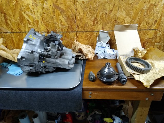

Hey All,
I installed a Wavetrac LSD in my 2014 Fiesta ST a couple months ago. I made a sheet with all the part numbers, some links, prices, and notes. I believe I listed everything on here so hopefully it will be helpful to people looking into doing this install. If there is anything you see that I forgot to add to this doc, let me know and I will add it.
https://docs.google.com/spreadsheets/d/1adAcwv1-jLLsVmsJ_p3f63JBfCDnGxfHwhcZooGjUUw/edit?usp=sharing
Also here is a picture dump of a bunch of pictures of the install. I have some videos too I will try to add at somepoint if I remember.
https://photos.app.goo.gl/6DzwV7Au2JxbKJbq8

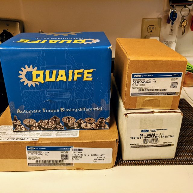

Thank you! So freaking helpful.
I was able to pick up these parts, BNIB for a good deal from a Facebook page. Can't wait to get these installed. May go ahead and replace axles and wheel bearings while I'm at it

^^How do you like the Wavetrac so far?
Does it seem to help out more when going over the curbing/lifting a wheel on track over any of the other FiSTs there with the Quaife, or MFactory diffs?
It is AMAZING! Installing the LSD was a lot of work, but it is one of the best mods you can do to the car in my opinion. The way the car pulls out of corners especially low speed ones is crazy. Also the car is super predictable because you are not searching for grip as much.
I have never driven a fiesta with a Mfactory or Quaife so I can't compare them, but i can say even when going over curbing or in hard cornering the car feels amazing!
