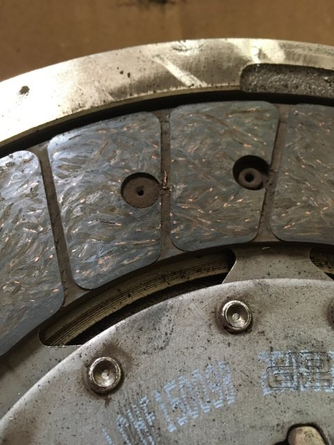

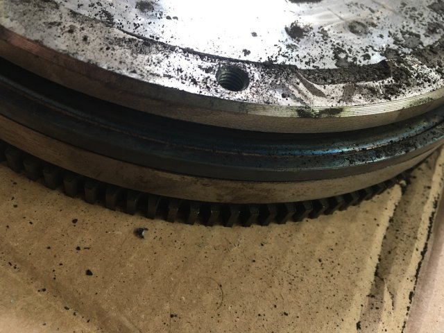

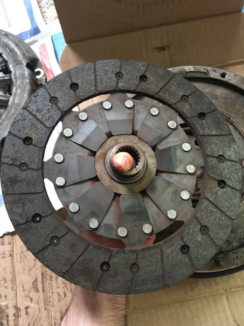

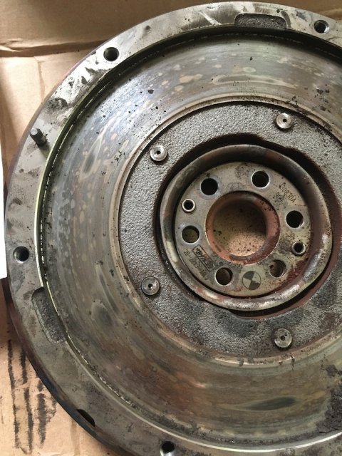

Attaching some bonus pics of the flywheel and the clutch, would love to hear if this is an example of abused clutch or not. The car is my first manual! EDIT: this is at 50k miles, mostly city

Looks worn and contaminated.
Would you say it's just the clutch material or there might be oil as well? This is the only thing I'm really worried about. Techs _say_ they didn't see any leaks but...

That clutch definitely looks abused. If your throwout bearing had grease in it and it failed then yes it would get on pressure plate clutch surface and flywheel and make it look like that in my opinion. Combined with being a first time clutch driver kinda par for the course. lol
I remember how my first clutch looked and I learned how to drive clutch on it trial by fire. Bought the car jumped in it and just started driving it till I learned. Learned about not riding it as in not taking it out of gear take your damn foot off the clutch pedal period! Thats what dead pedal areas are for. Put your foot there! lol Its really easy to get lazy and let your foot rest lightly on the pedal thinking your not depressing it its ok. But that is what kills throwout bearings and causes mild ride the clutch damage. Don’t ride the clutch .
Once a person learns proper clutch technique the clutch can last the life of the car unless you dump it and spin your tires all over the place. lol Though even with some of that with proper clutch etiquette in between it will still last well past 50K .
I was right there with you I did my first clutch in in 50K . After that it was like clutch is fine drive the car foot off pedal we good. Clutches then lasted long time unless I bought the car used and got someone else’s clutch then it could be iffy.Also when I started making performance mods for more power thats when clutches could be toasted faster. At that point it was beefier clutch time.
Ah I ramble but its all to make a point. You will do better with this next clutch I am sure.

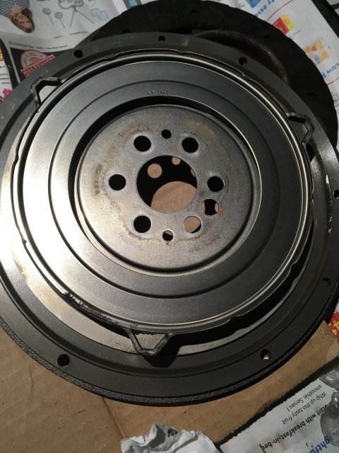

If anyone is interested, I cracked the flywheel open; here's what's inside.
The two pieces were held together by the two small rivets in the middle you can see on the previous photos. I suppose it doesn't really matter because there are also 6 bolts going through there as well when the wheel is attached to the engine.
It's a bit hard to see from this view, but there are actually two springs in each of the 4 segments in each of the 3 groups - the outside one of larger diameter and the inside one of smaller one. When I try to move them by hand, they are very snug. If the top plate is back in, however, there's a clear slack, so looks like either the springs were shrinking or the plastic inserts were compressing/wearing out.
One more interesting detail is the very visible metal coloration on the circumference of the wheel. What I first thought was the result me riding the clutch turned out to be just weld marks :LOL:
