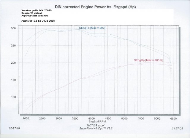

Works fine. The throttle response is much better.
Comparing with the original one gives also slight torque and power increase - see attachment. Grafy z brzdy_porovnání _text27082019.jpg
