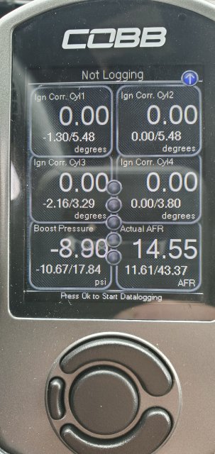

as stated above, I thought it would be fun to see if anyone could identify why I'm having such wonky numbers pop up. I'm running the cobb ots stage 1 map but I most deffinately have more then just a drop in air filter.
Mods in clude an MBRP 3" Catback
2J RACING full race 3" dp ( catless )
Injen CAI
I have spoken to nick at cobb and I gotta admit, dude has a sense of humor hahah he essentially told me user error is why I'm getting the results I am ( -2° of timing ), so yeah, what do you guys think i did wrong and what potential damage do you think I could of caused?
Edit: I know people like seeing logs, but use been expressly told to NEVER go wot untill the situation is rectified. Like i said, great sense of humor, our conversation concluded with nick saying happy boosting ( later on) 😂

Get a Custom Tune, them OTS tunes aren't that good. Also might try to get new plugs NGK 6510 one step colder. Don't think you've done nothing wrong really.

Put the OEM Downpipe back in the car. It's been tuned for the OEM Turbo and will yield MORE power with the stock turbo than an aftermarket DP.
My bad i meant to mention I run ngk one step colders from napa gapped to .25 or .025, im iffy on the gap tho, I feel like it might be too little by a point or so

What fuel are you using? Ive had no issues running the ots 91 octane maps on 93 octane fuel. I only see minor corrections on 91 fuel. How many miles in the coils? One may be getting weak on you.
I'm at 110k km on factory coils, never been replaced ( or atleast not mentioned in service reports ) car has only ever seen 91 octane or higher, however cobb said canadian fuel isn't the greatest in general. I monitored oar when I first got the accesport ( 3 days ago ) but it never moved from zero so assumed I was good

Data logging will help figure out what’s happening. Your negative correction may be perfectly normal, however.

I did read that blog, thats why when I saw -2 I was like o.0 uh oh. Ive been monitoring boost and ive not gone above 19psi. But like I said after speaking with cobb im paranoid to even try wot as I got -2 on partial throttle in second mid rpm band.
I did read the fuel tables learn best on WOT, i just dont wanna throw a rod in the attempt to balance my fuel tables. But im also paranoid lol
https://stratifiedauto.com/blog/und...ons-in-your-high-performance-ecoboost-engine/
And see this is where I get confused. Are my ignition timings wonky because I back out as soon as I see -2° correction instead of powering through the pull to allow the fuel trim table to learn properly. Or do I listen to cobb and NEVER go WOT to prevent overboosting and damage? I'm going to try to snag a log ive never done it before but I did set the parameters stratified recommends for data log refinement. I'll see if I can post some later.
I'm almost wondering if I should just say f it and go WOT to allow the fuel tables to learn properly. I only have like 50km on this ots map so the car might not of learned its fuel trims yet

Maybe just log under light load, to see if the knock is sustained or fairly infrequent.
The more I read into it the more it seems either my fuel is sub par or I just having given the OAR time to adjust properly, im gonna give a semi go, like half throttle see if it happens again. Weird thing is its not ALWAYS under half throttle, for example I did a pull earlier in 2nd and had .8° correction so I almost feel like its a fuel / not giving it enough time to learn the fuel trims correctly
Update, went and did some driving ( 50km ) various gears and loads, i did notice a -2 fuel correction when i downshifted from 6 to 4th to take an exit ( i was just cruising ) and ive noticed -2° timing however it never happens at the same rpm or under the same load. It seems to at the most random of time during a pull. Could be right at the start could be when I get higher up in the rpm band. I DID however notice that cylinder 1,2 added 6 and 5° timing while cylinder 3 and 4 could only add 4°.
Now I'm starting to wonder if the gentleman who mentioned coilpacks may be right and it may be time to replace them
