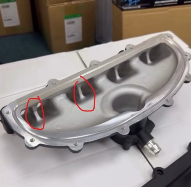

Good thing is, that beside the old Anembo, we have now an alloy alternative - but it is far from an optimized design - especially the sentence about "CAD optimized runners" → internals look worse than OEM: note the thick blocky casting on the Pumaspeed unit and compare to slim smooth edge on the stock unit.

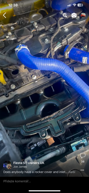

As for manifolds not splitting... they do, check out this lad from IG

Usually they will separate if there is Fuel pooling in the intake. Even the metal ones can separate the case halves as ive seen on the Rs platform.
