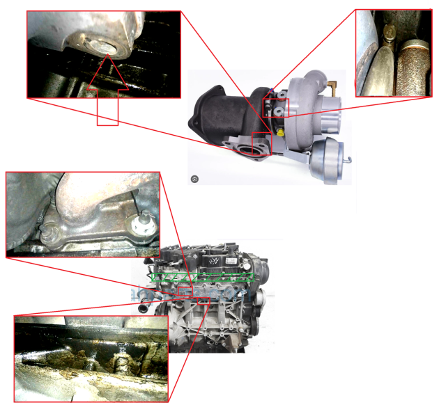

7. Changed the valve cover and vacuum pump gaskets chasing the oil leak. Finally found it on the back where one of my bolts fell out of the Manifold to Turbo, the extra oil from the PCV finally being closed off from the leak I had had oil slipping through and burning on the back side of the engine. This was a pain to find, ordered new hardware which just came in and going to close up the pipe tomorrow.

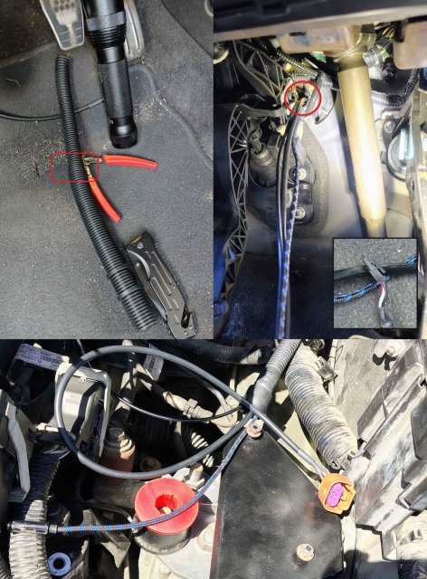

It was kinda hot today, working on the car in a parking lot with no covering is exhausting. But I did get the wiring for the Ethanol sensor and the boost reference line routed, bonus I got the audio cable for my videos also through the symposer hose.
It was kind of a pain as everything I routed was getting stuck, took my borescope (Get one, you won't regret it) and ran it through it and saw several hard bends that it couldn't get through, decide to cut the hose right at the firewall cabin side. Turns out that is pretty much exactly where everything would get stuck. Also found that the hose shrinks in diameter once it gets into the grommet engine bay side, and then a bit further in the cabin it opens back up. That is probably what gives everyone trouble. I'm posting what I did and where I cut as I couldn't find anything like this on the forums or google searching. I was even able to get the 3 pin connector through without needing to de-pin it.

I also noticed I didn't post the image of the oil leak I had in the bay that was causing smoke. So here is a diagram of that. When I fixed the PCV hose I was dumping a lot of oil into the intake which was going unburnt, that was getting into the exhaust and the exhaust had a leak from the bolt falling out and was causing oil to appear on the back of the block and out the exhaust too. And I mean a lot of oil, this looked like a valve cover leak, which it I had replaced. I only found out it was the bolt missing since I bought a borescope. Which I highly suggest with how cheap they are now, even the ones that plug into your phone would help with finding this sort of stuff.
