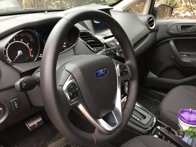

The steering wheel on the ST-Line Fiesta is has a little more rectangular shape than the ST. It seems a little larger in diameter too. It also has the orange stitching to match my ST with the molten orange interior. My daughter has this on her Hot Pepper Red ST-line. It's nice, what gives Ford??
