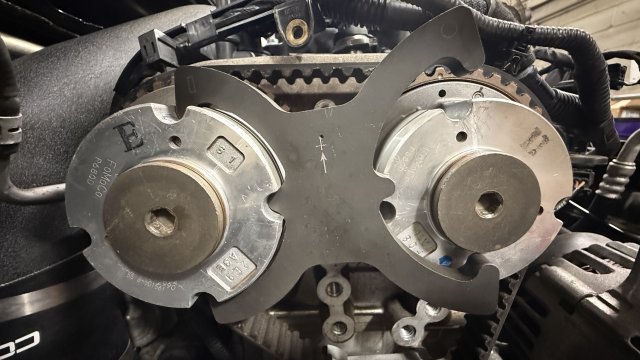

maybe when you put the new timing belt you timed it too advanced, were you sure to lock the cams and the tdc pin?
So shop foreman is looking at it. He's gonna check if the timing is off. He said the cams have 5 degrees of compensation that'll not throw an engine light or misfire but be down on power.

Thread Starter #24
Final update. It was timing. Computer didnt pick anything up and all values looked good but crank had rotated back a few degrees when loosening the pulley. There were no misfire and no other symptoms other than lack of power and a stumble when the clutch was pushed in
