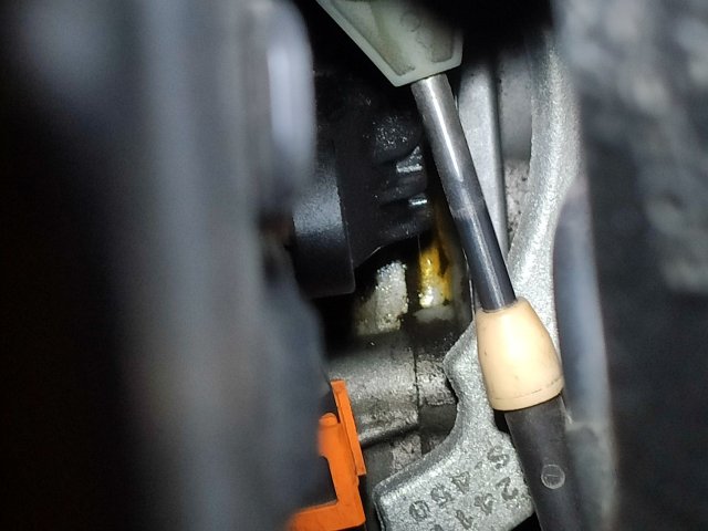

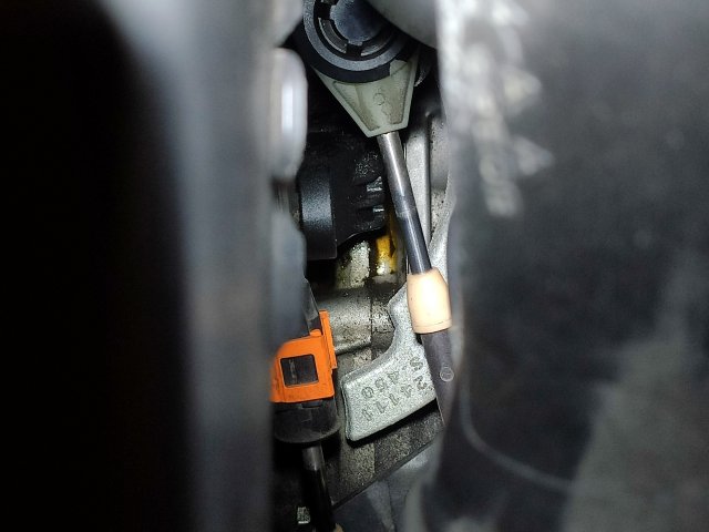

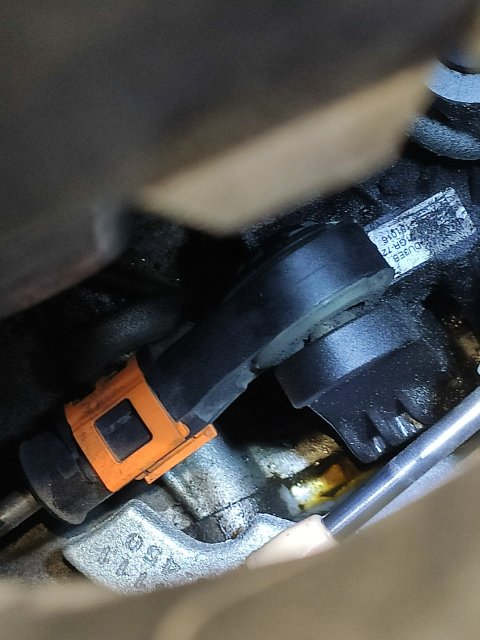

Hello everyone, I kindly wanted to know if it has ever happened to anyone.
It would appear to be a small oil leak (looks very clean) from the top of the gearbox, just below the shifter cables.
It is not a constant leak, sometimes it is there sometimes it is not.
Does anyone know what it could be due to?
A worn-out gasket?
Thank you very much!

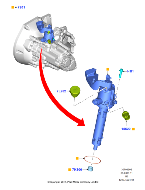

This illustration is from our US version (our MKVI, your MKVII) but maybe the seal to the gearshift housing assembly?
