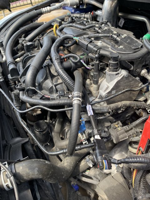

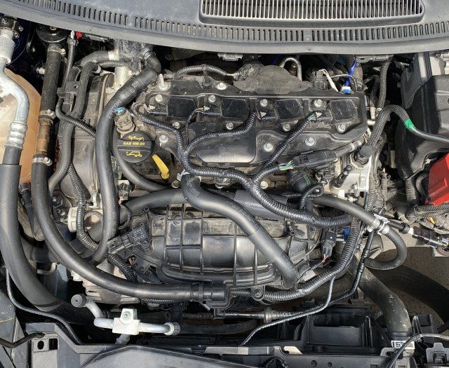

I routed everything (MAF extender, vaccum and the valve cover hose) through the little valley between the intake manifold and the valve cover right under the injector wiring. All of it fits under the engine cover while still having the sensor in place. All I had to do was twist the hose with the sensor the other way. The larger hose goes under the coolant reservoir and goes straight to the intake. Third pic shoes the check valve placement. For anyone reading this in the future, if you forget the check valve (little thing with the white on it shown in the 2nd picture) you will have a high and irregular idle, ask me how I know lol.
Side note: I do have the 2014-2015 evap line that Ron @ Whoosh carries
Link for evap lines: https://whoosh-motorsports.myshopif...-to-convert-2016-fiesta-st-to-2014-2015-specs

Here's something I find interesting, you have the check valve close to the lines, versus I have mine close to the intake. I doubt that would change anything, but it's something to note

With no install instructions I'm not surprised when I see pics of this intake installed and little differences here and there lol. It might be worth a shot to move the location of the check valve, the check valve is around that area to begin with. I would think 48 inches of that line would be pretty cheap

My check valve is right at the hose that comes out of the evap line. My car had a high idle before the check valve
