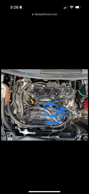

Yo I’m a little late lol but coming out of the crankcase hole did you use the oem tube and just run it into the 2jr provided tube ? I’m getting a code and if you didn’t then I’m just going to copy you. I’m guessing it might fix my issue I used the bigger grey and orange tube directly to the crankcase. Any help would be nice:/

If got the grey hose I highlighted, I got it running straight from the crankcase hole could that be why I am getting code ?
I used the OEM elbow, then it goes to the gray supplied hose, then to the intake I believe. I unfortunately took this intake off years ago, so I don’t recall exactly how it went
