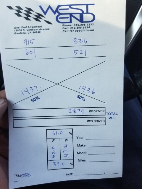

Here, I can tell you what your real world expectations will be. I've done everything more than "practical" to lighten this car. You name it, I've done it. When I had the car corner balanced, it came out to 61% front, 49% rear with a total weight of 2860lbs. That's with a roll cage and me in the car. So without a driver and the roll cage, your looking at 2500+ lbs. A highly doubt someone can strip this car down to be under 2400lbs.....especially trying to keep it "practical". 200hp in a 2500lb car is not very impressive. To put it in perspective, the car I'm building now, is 265hp all motor, 1800lbs (with a full roll cage) and running 265 wide tires (square).
The Fiesta IS a great, fun canyon/mountain car tho.
