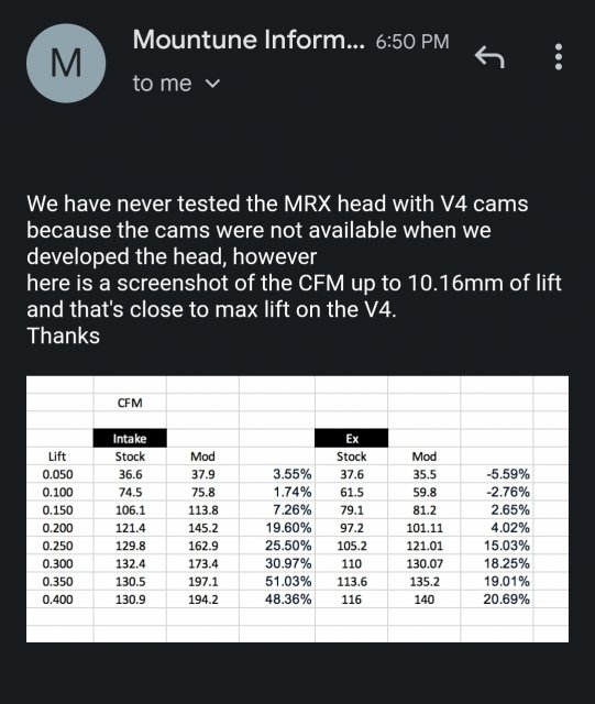

UPDATE 2: Mountune comeback with the receipts!!!
Nice quick response from mountune with data to back it up, I'm sure the puma speed head is OK but without flow data...I can't back it.
Funny all we had to do was ask instead of speculate 😉

That's cool that they immediately shared their data or spoke to not having any to share.
