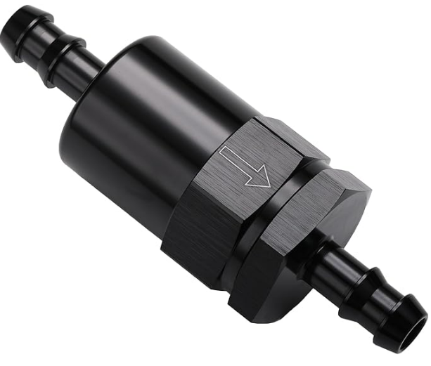

Thanks for the info. Since I'm using 3/8" hoses, I ordered 3/8" Billet Inline Fuel Filter 30 Micron Aluminum Black that you posted above. I got rid of the cold-side pipe to induction hose tubing so I don't need the second check valve. I will place the fuel filter on the hose between the firewall and purge valve to see if causes any issues or CEL.
That looks like a nice one to go straight to some fuel hose. I might end up going with it as well.

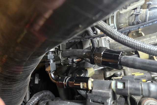

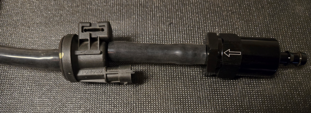

Installed the fuel filter as shown below. Didn't see any issues during the test drive. I will be driving a longer distance tomorrow so will see if this triggers a CEL or not.

I replaced the purge valve about two years ago and haven't had any issues since. I fueled up today and didn't have any issues either. If your purge valve is already shot, you'll need to also replace it. Too soon to tell if addition of the filter is the solution but at least it's not causing any issues.
