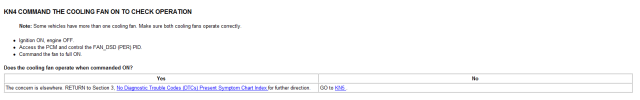

ForScan may be useful for manual activation...
