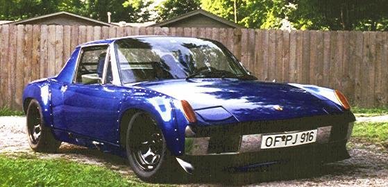

Nice work but you need to get cracking on that 914-6 sitting abandoned behind your FiST in the first shot. While not even close to a supercar back in the day the 914-6 was a great balance between compliance and cornering ability and at 2100 lbs the 125 HP motor made for rather decent pep back when emissions controls strangled any car sold in this country. BTW, I'll bet someone with talent such as your just might be able to shoehorn a WRX or old air cooled 911 Turbo engine into that Porsche.
DAMN THATS A GOOD EYE

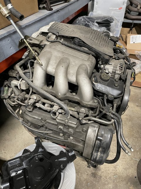

You mean something like this? Yep 3.3 EG33. I have a 2.5 RS close ratio transmission to go with it. IMG_1486.JPG
This was my first car. Daily drove it for a couple of years. Totally fun for a 25year old but I don't tolerate old car shit well anymore. A warmed over 2056 with dual 44webers and some short ratio gear box. That car was a riot and crude as hell. Had to carry a towel to sop up the water leaks around the Targa top and windows, no heat, no defrost, no radio, no bluetooth anything. It was entertaining. I learned a lot about building cars with this one.
The Yellow car is my 401K and its gonna get some cool shit. I am wanting to do a steel roof, but need more time with my english wheel to get my skills up to doing such a panel. There is a pile of 996 Suspension components in the corner that I need to integrate into this car, plus a few rust repair panels. This one has no floor pans.
