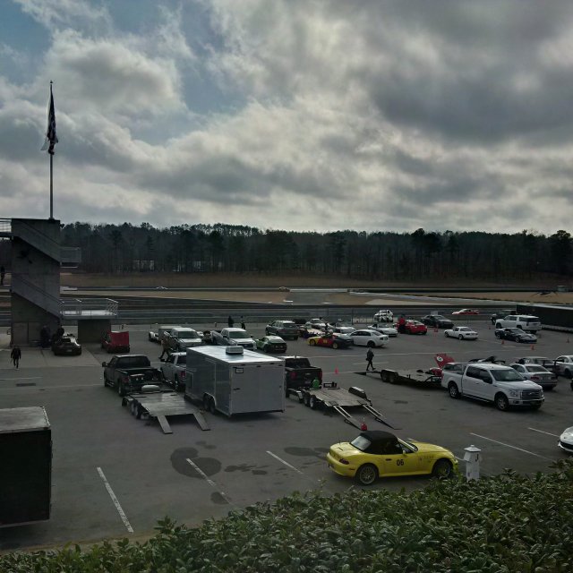

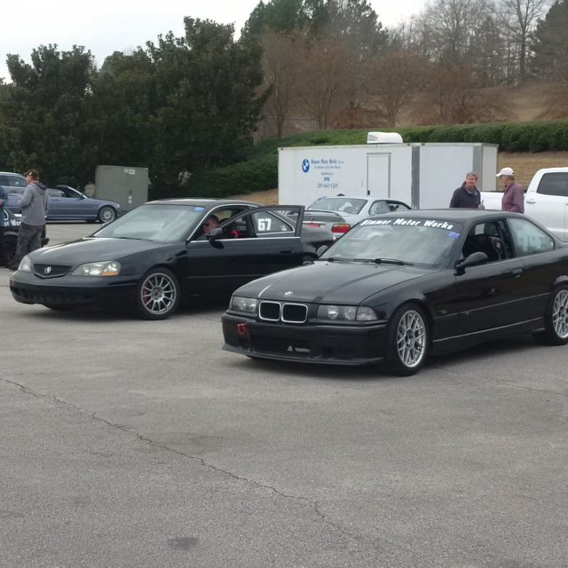

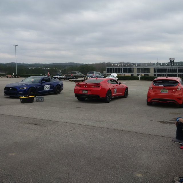

Spent Sunday at Barber Motorsports Park with Just Track It. It was just a one day event so it fit nicely in the schedule. Several friends came down with me. A Mustang GT, Camaro ZL1, Acura CL Type S, and the E36 M3. All much more track oriented than the Fiesta.
Ran the car with the new brakes. They felt great. The pedal felt consistent throughout the session. I didn't even bother to put in my normal race brake fluid when I installed the kit. I ran out of time Sat to replace the fluid with the Wilwood fluid before loading on the trailer. So out we went with the Oreilly's DOT 4 fluid. HAHA.
The BP20 pads didn't hold up well for me. I cooked them to death. I also didn't have time to hook up my brake ducts before going either. (Had to rewire the trailer lights), but the my big brake setup has proven itself so I am happy about that.
I spent the day trying to get the car to rotate better. While not bad, I jammed three spring rubbers in each rear spring upping the rate 100-150lbs to get the car to turn. I'm running the Suspension Techniques lowering springs with stock shocks. When the time to change the shocks I may go to the Bilstein B14 kit.
I know this is on me as I'm not set on turning this into a track car. The Fiesta is a great street car, a kinda fun car to run at the track, but its never going to be a great track car.
Definitely want to add some more power. Looks like I am going to order a S280, but I am going to try and figure out if there is a better fuel pump option. Not a huge fan of aux fuel. IMG_20191215.jpg IMG_20191215-2.jpg IMG_20191215-3.jpg IMG_20191215-5.jpg
