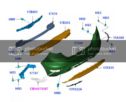

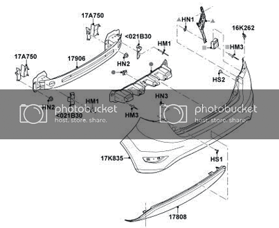

US SPEC:
EU SPEC:

does anyone know if EU rear crash bar will mount up to the US vehicle plug and play?
id be glad to buy an EU rear crash bar and bumper if it will work properly.
Yes, minus the fact that they do not comply with NHTSA standards and if you ever got rear-ended the damage might be considerably more than what i would be with the US spec parts.
Look at the diagram, the EU spec is literally just a bar to help support the bumper. Ours is an entire beam assembly designed to absorb low speed impacts.

Thread Starter #15
Honestly that’s why I’m more interested in the original posts variation.... I’d much rather install the dual exhaust lower valance from said maxton style eu bumpers and just for them to the US spec. I don’t think a full conversion is totally necessary. I’d be happy to fiberglass and body fill/paint any fitment.
Just trying to figure out if anyone knows a nice dual exhaust lower valance like original pics but that fit US bumper.
