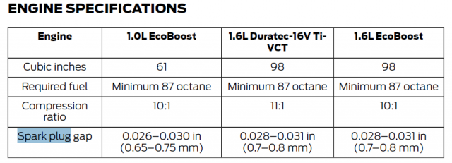

On stock tune it seems like torque/power drops-out before 5800... like you're just spinning your crankshaft well before you get there. Like others I assumed this was a limitation of the turbo. But if what they say is true, timing could well be a factor. At 5800 rounds over 60 seconds, the piston takes just 0.010 second for an up AND down motion. In other words, that piston will move up AND down over 96 times in just one second. I can understand being more conservative with timing.
Compared to prior generation engines which ran pretty cool, manufacturers altered their engine management strategies to intentionally run them hotter for improved emissions, with the added benefit of significantly reduced carbon buildup in the cylinders. Running plugs that are too cold can result with inefficient burn due to fowling which is at even greater risk of occurring when engine temps aren't hot enough, long enough, for successive operating cycles. I'll leave the cooling system and other hardware alone. At most I might consider the step colder with smaller gap plugs and Adapt-X.
Mine stayed happiest with 1 step colder plugs, I just order the pre gapped ones from whoosh every couple oil changes
