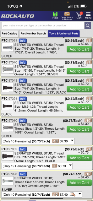

Rockauto lug stud

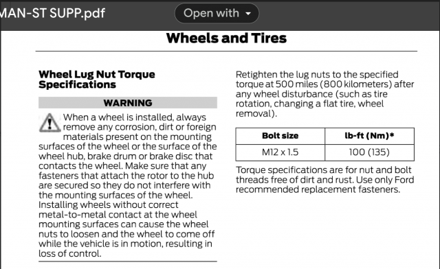

The proper size is M12x1.5 thread.
Length should be the same as what you have unless you wish to add any spacers.
Color is your choice. (OEM is silver)
Corrected
