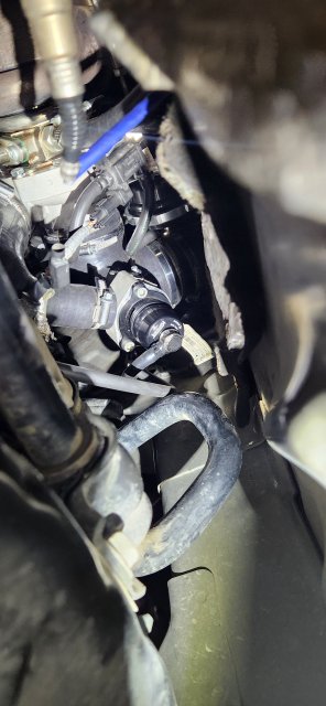

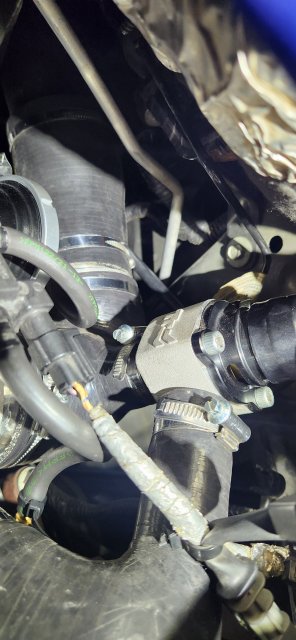

I think I see whats going on here. Is it just me, or is my diverter valve mounting block in the plumbing in the opposite orientation to this set up? I think they installed it backwards. The valve in the bov is pointing towards the compressor and not the pressurized air coming out of the turbo.
Grsemky
U.S. Navy Veteran
413
333
Arizona
#28
It does look like the blow off exit is pointed towards the compressor outlet, instead of towards the turbo inlet 🧐🧐

That has to be the problem then. My mechanic was telling me to run the intake return to the bov to atmosphere, but I noticed I still didn't have any bov on the test drive so I was racking my brain trying to figure out what in the world could be different about the set up. That's the problem. I can't believe we all missed it this long.
DrivenMind
22
21
Atlanta, GA, USA
Thread Starter #31
That was it. After looking at that picture and realizing what I was looking at, I had a friend give me ride over to the shop and grabbed the car. I got under it an hour ago with some hand tools and pulled the bov adapter and oriented it correctly, and reconnected the intake return from the BCS to the block the bov sits on. That was of course the issue with the bov not working too. Its properly quick. On the base map its spinning 3rd gear up to 85mph at like 28psi. (Granted its cold) But I'll be pretending the fireworks are for me tonight. Thank you guys for your help, I can't believe it took that long to figure it out.

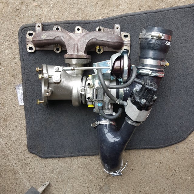

did you get a pic of how it is supposed to be setup?
The post is above. The bov is there to vent pressurized air and return some of it to the compressor to keep the turbo spooled. It can't do that if the blow off valve isn't facing the pressurized side of the pipes. The way it was oriented the turbo was effectively pressurizing the the ported block with the intake return line meaning the boost control solenoid was not seeing differential pressure, and had nothing to reference to control boost.
