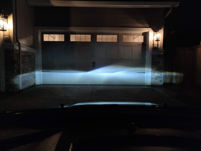

I left the headlights aimed the same so I just swapped in my bulbs that I had prior to the leds. I even touched the bulb with my ungloved left hand.. :-/. I'm so dumb.
Anyways, I'm going to see how they work in comparison on this one road in particular.
I emailed Constantine asking what would happen if I get the TYC lights and they won't adjust. I'll probably order them.. I really miss the cutoffs on them and I'll just use the techmax in my fogs.
HHow do the katanas look in the euro projectors?
I posted it a couple of pages back but here it is again:
