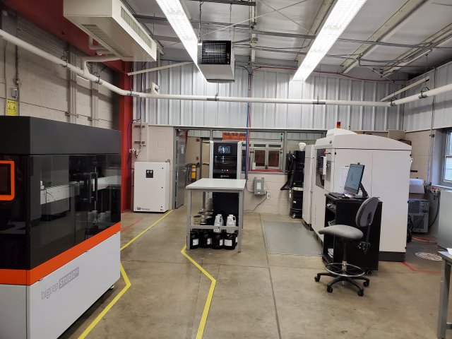

It's actually me myself, I am a student worker at my college in the manufacturing lab 20191105_134259.jpg

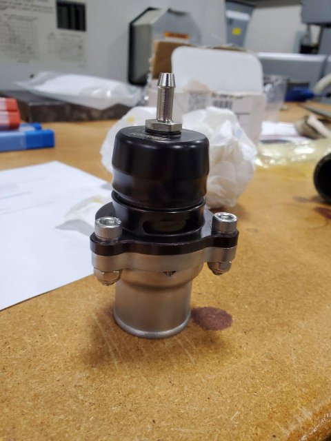

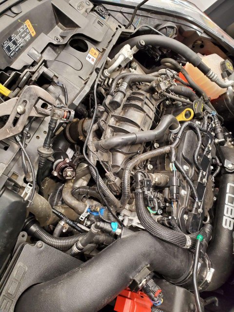

Completed machining my BOV adapter to mount my factory replacement Turbosmart dual port in the symposer location. I ordered some heat tape on a whim, I'm going to wrap the cold side intercooler piping gold. If I'm honest, it was cheap and our cars are boring under the hood. I talk about what I have done, and everyone asks to see under the hood. photo_2019-12-09_01-47-04.jpg photo_2019-12-09_01-47-08.jpg

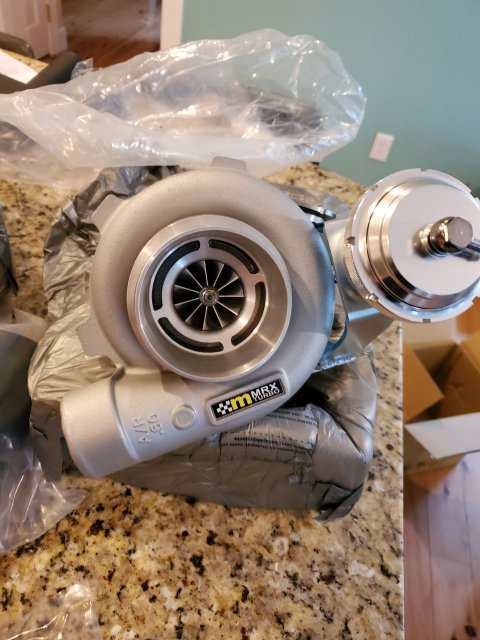

Well, first drive is over. A very challenging install, and not without it's issues. The powerband is completely different. On my wastegate map it makes exactly what is expected, 17.5 psi. However on my other map it's only making 20psi when it should be 27. Also there's coolant in the passenger wheel well yet all the lines and fittings are dry. Could it be I overfilled the reservoir? What things should I check? Also a small exhaust leak, I reused the stock gasket

The body of the wastegate has two threaded holes, do they need to be capped? There's a part with a plug and a nipple that I can find no mention of in the instructions, they call it a seal kit
