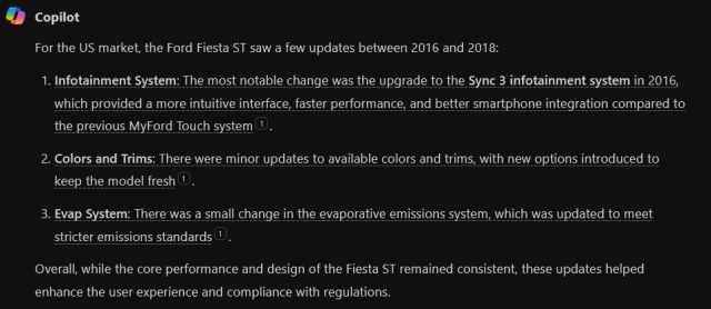

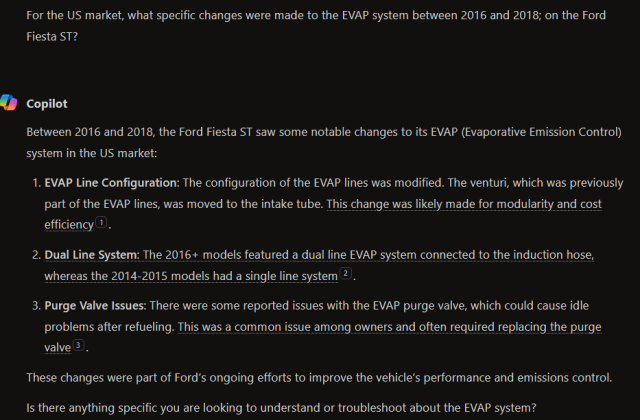

Based commentary from Microsoft's chat bot, @FiestaaaST might be referring to the EVAP system? This could entail programming changes; not just hard parts.
This answer merely leaves more questions...
