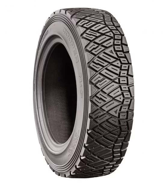

Sounds like the roads are designed for SUVs. Maybe those pristine utility vehicles really are getting some simulated "off road" use. :LOL: Yip the snow plows eat up the roads and the road salt melts the vehicles.
Been lucky with 215/45R17s and haven't needed to go to a 16 wheel. I do maintain tire pressure around 40PSI front. Rear needs to remain closer to stock pressure or it begins to fish tail too easily.
There can be a massive difference in tire build between manufacturers. Some have comparably weak sidewalls. The wallso on the Coopers I have aren't as strong as the walls on the stock tire.
