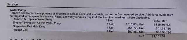

Yes, I do have the costs for my timing belt. I trust the mechanic I go to to give me good prices tho he is part of a chain of stores called Tire Tracks USA that was recently acquired by Great Water 360 Auto Care. (so, not 'a friend of mine'). I attached a pic from the invoice. The water pump has to be replaced apparently (or he did 'slam' me!) when you are doing the timing belt as it shows one kit with that name 1980 capri turbo rs orange.jpg Timing belt charges.jpg . He also said the Serpentine belt looked worn and is no extra labor to do while you are doing the timing belt, so I did it. Of note, when they got it back together, they found a bad coil and ended up replacing 2 coils when the problem hopped from 1 to another coil, but they only charged me for 1 coil as shown. Just a heads up, in case something like that happens.

Your mechanic definitely did you right replacing the water pump, the last thing you want to do after paying for all that labor to get to it is to put an old water pump back on, and it also makes lots of sense to replace the serpentine belt at the same time.The timing belt /water pump combo is a good example of while you're in there type repairs, which I am a big believer in. The price seems reasonable, I'm having mine done based on time, 8 years next summer, since I'm doing low mileage, and I would be fine with a price in that range.
