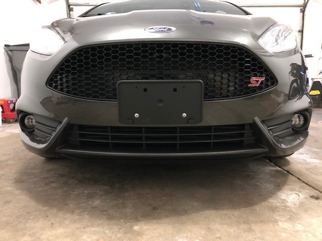

I learned by doing, and I hope you learn from my experience.
First, ignore all the comments on installs on Amazon.
Polarity was correct, out of the box. I was able to install them by removing the headlights. I started out trying to get to them by taking off the fender liner, like all the how-to videos say to do it.
It's a cuss-worthy ordeal. I tore my forearms up doing it, but all you need is a T25 and a Phillips. If you have gorilla arms and big hands like I do, you will bleed.

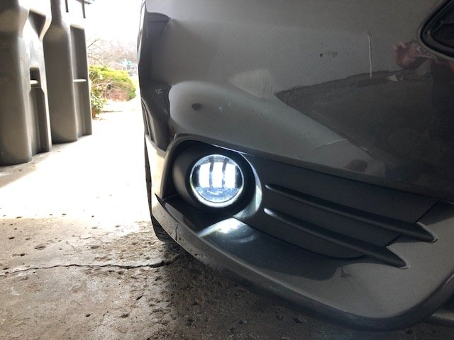

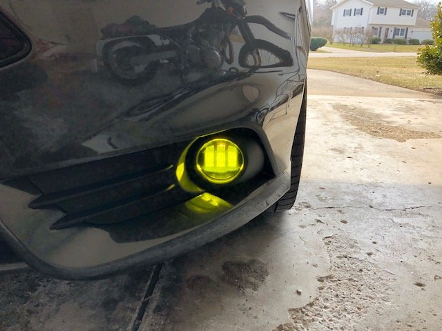

I saw those amazon reviews. Which way did you orient the adjustment screw?
They're a universal thing. I arranged the lights so that white was the "fog beam," and yellow was higher.
You can arrange the lights in the mount so that white is low, yellow is a bit higher, and the adjusting screws are on top.
I adjusted nothing, and they were pretty much on point.

They were. There is at least one baby deer who is alive today because I had the fogs on yellow. My car is likewise unharmed.

Did they give more throw or brightness when driving than the oem fogs?
Oh yes, the white is a lot brighter!
